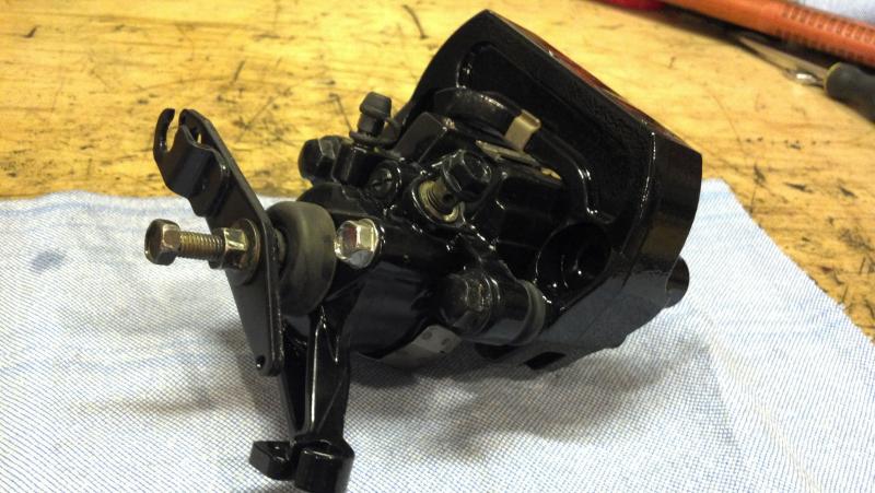

will get a few pictures in the morning. I got an Eastwood hotcoat powdercoat kit and ive been powdercoating some little things. Anything that will fit in a toaster oven lol
PostPosted: Fri Jan 13, 2012 8:16 pm
Here are a few pictures. Not a professional job, but this was only like the 4th or 5th thing ive done. Still learning! I really like the way the powdercoat system works. Much nicer than paint IMO

Looks great - Nice work. did you use the seals i sold ya?
PostPosted: Fri Jan 13, 2012 10:59 pm
Not yet, going to save those. The seals in this caliper were still in good shape. It didnt leak at all when i tore it apart so i re-assembled with the old seals. if it does leak i will use the new ones. I just want to keep those for as long as i can. never know when one will break/crack and i will be needing a set.
