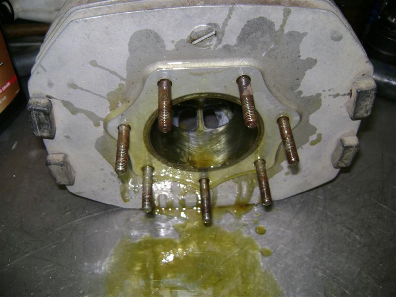

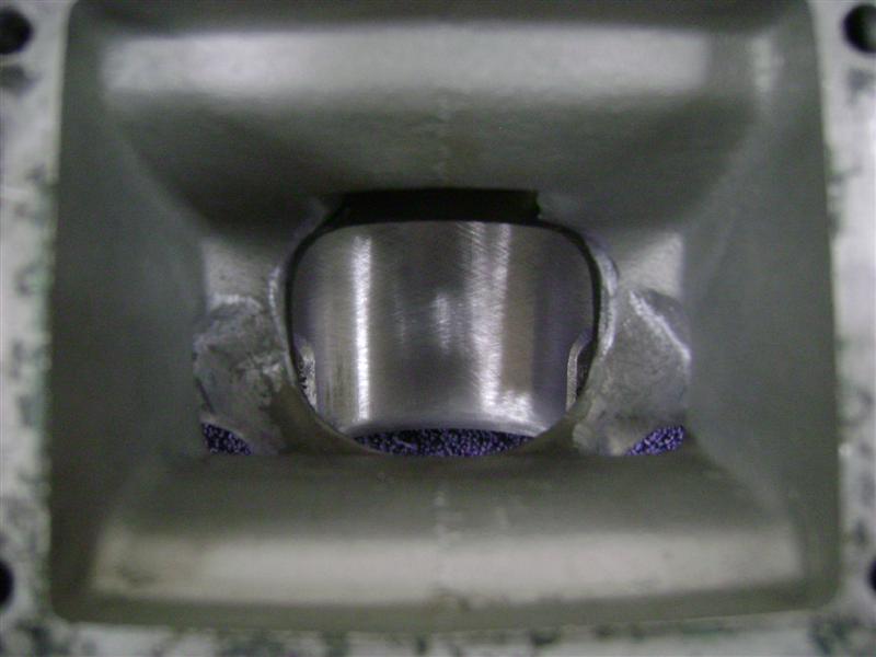

Ok your cylinder is done, their was some really ugly casting flaws on this thing I could not allow them to remain in place choking your Engine every time you run it, so I spent a little time and knocked all them down smooth them out and blended them in, the piston was prepped and I drilled the cooling/lube holes for you.
PostPosted: Mon May 17, 2010 5:17 pm

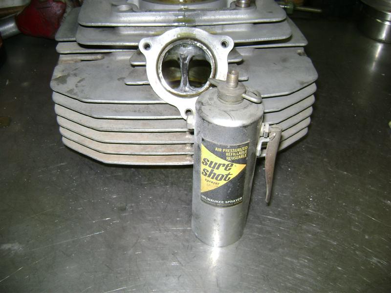

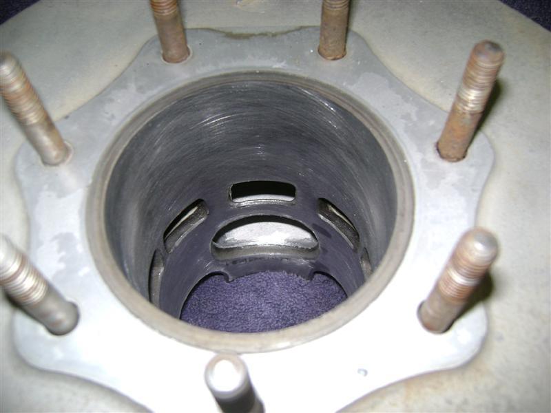

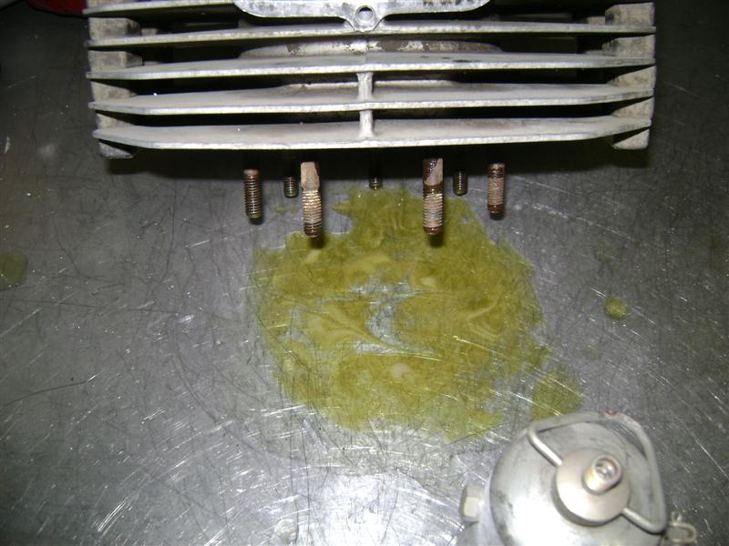

Your cylinder bore was not cleaned you will need to clean it, I got out my refillable lubricator and filled it with Engine oil then sprayed the cylinder down good so their is no way it can rust, its a new policy in my shop I am not taking any chances after seeing GarlicGreg's cylinder, that has never happen and I want to ensure it will never happen again, I never did figure out what caused it to rust like that, nothing in my shop is rusting like that either.
Sorry for the mess
PM me your address again I will ship it right out to you.
