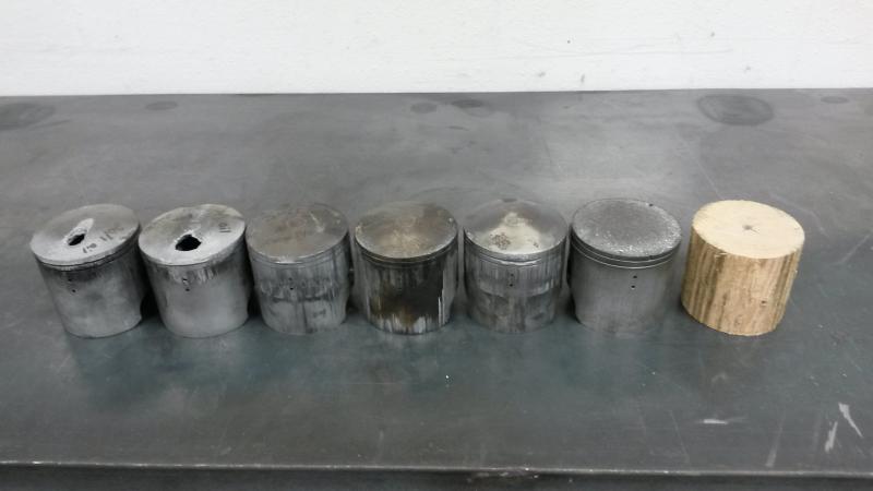

Here is one of my threads: viewtopic.php?f=2&t=14359&hilit=collection
Below is a picture of my entire collection but it does not reflect the actual amount of melted pistons because many I just filed out the ring lands with a nail file and put it together again. By the way, I think that's what you will have to do with your piston as well or the rings with be "sticky".
I actually have an Engine in one of the Oddy's that has a welded piston and it's been in there many years. It still runs. I welded the hole in it and also welded up the ring lands.
All of my engines are now liquid cooled. I cut the fins off the heads and cylinder and welded on cans.
CO

PostPosted: Tue Aug 20, 2024 4:34 pm
Jay727 wrote:
Can I get the specs on that wood piston? :-)
Baahahahaha ------ actually there is a function for that wooden piston.
In the center of it is a drill hole.
This wooden piston is what I use to guide the pilot drill for my 6" hole saw that I use to cut the fins off of the cylinders so that I can liquid cool them.
CO

Jay727 wrote:
I would file/sand the high spots off the piston, file the burrs off around the ring grooves and make sure the ring lands are clean and the rings move freely in the grooves.
Drill a 3rd lube hole.
Relive the bridge in the exhaust port slightly. I will let the 350 experts chime in on the details.
When you push the wrist pin through the piston does it slide in and out normally, sometimes when you over heat the piston it will collapse the skirts of the piston slightly and you can feel resistance when installing removing the wrist pin. Its not a big concern if you can install and remove without a wrist pin puller.
DO NOT KEEP FEEDING IT PISTONS until you get it running right and the jetting safe, but at the same time consider that piston needing replaced, by now your good at removing the cylinder you might pull the cylinder off with the head still on in 5-10 hrs of run time and inspect the piston, you will need a second person to do this so you can focus on the rings and piston, have someone slowly drop the cylinder in place as you compress the rings and guide the piston.
Check the Vacuum line that runs to the fuel pump make sure its not leaking in the line or at the ends and sucking air, remove the fuel filter and back flush it with carb cleaner and give it a lite blow with compressed air see what comes out. Check float level.
After a LONG wide open throttle run do not just let off the gas, when you let off pull the choke and give it a slug of cool oil and fuel, close the choke and blip the throttle a few times.
What is the air temps when your running this and having the problems?
What am I forgetting guys?

What is your actual compression, assume nothing, have you checked the deck height someone might have machined the bottom or top of the cylinder, this will change the compression even with a STOCK head.
Post a picture of the head your running top and bottom the PRE-RECALL heads has straight fins they were higher compression they had a TON of problems with them. The newer style heads has the curved cooling fins to scoop more air and Honda lowered the compression.
I ALWAYS CC the heads to find the exact CC's machined or not. Someone could have put your head in a lathe and taken .20 off the gasket surface you would have no idea.
What head gasket you running, measure the thickness, compare to stock, I have had a bunch of 350's come across my bench where the owner was running 1 layer of a 3 layer head gasket for higher compression.
If your running a gravity feed carb you have the needle and seat for a gravity feed carb installed, Verify you have the correct setup.
PostPosted: Wed Aug 21, 2024 3:17 pm
I can hear your frustration in this post (long rant).
You have to understand that most of the people who are still left on this site are Oddy and Pilot experts and we have seen it all. We never get ALL the info when someone new posts so we read through the lines and guess. Everyone here usually rips a new bought machine apart to the frame and starts over fresh and each of us does it our own way.
The Oddy has a lot of issues and some of them I haven't posted for you yet because I don't want to overwhelm you. We don't know who you are or your actual skills so that's why some of the questions sound dumb to you.
You have purchased a machine, and like hoser said: "you don't know what the previous owner did to it".
It will be frustrating in the beginning, I know, I melt nearly a dozen pistons before I figure it out.
This issue for you is fuel detonation.
The pump gas will detonate on an Oddy. It's not a dirt bike. So your previous experience with two strokes has only half value.
The pump gas detonates on an Oddy and blows a hole in the piston because the Engine is air cooled and it's behind a seat with very limited, and in my opinion, inadequate air flow. This causes the intake charge to have an elevated temperature and when it gets into the combustion chamber and the piston starts to compress it, the fuel just detonates like a diesel Engine because of the poo fuel.

Jay727 wrote:
What is your actual compression, assume nothing, have you checked the deck height someone might have machined the bottom or top of the cylinder, this will change the compression even with a STOCK head. I don't know, it's apart right now waiting on parts. What the deck height supposed to be? that's not in the manual either. I can tell you of every type of Engine I've worked on the deck can not have been lowered, the piston edge is at least .125 in the hole.
Post a picture of the head your running top and bottom the PRE-RECALL heads has straight fins they were higher compression they had a TON of problems with them. The newer style heads has the curved cooling fins to scoop more air and Honda lowered the compression. I'm not running a pre-recall head, can you take my word on that or do you still want a picture?
I ALWAYS CC the heads to find the exact CC's machined or not. Someone could have put your head in a lathe and taken .20 off the gasket surface you would have no idea. Whats the CC of an unmachined head? Documentation, because it's not in the service manual
What head gasket you running, measure the thickness, compare to stock, I have had a bunch of 350's come across my bench where the owner was running 1 layer of a 3 layer head gasket for higher compression. I don't know but it's .005 thicker than the stock one
How many times do I need to say it's a gravity feed carburetor?
And yes, it's a chinese carburetor, it's not a $30 one, I bought one of those just to look at it and sent it back. I have a genuine 38mm Keihin off a 2000 CR250 right in my desk drawer I used it to replace the Mikuni TMX on my 2001 CR250 but I swapped the TMX back on. The chinese carb is not bad quality.
I'm not measuring the deck height and cc'ing the head because no one has stock OEM specs. It's easier to measure cranking compression. Don't you want to mention dynamic compression? Well it hasn't been ported I'll bet money on that, I'd bet the cylinder base, deck and head has not been machined.
Well then keep feeding it pistons and good luck.
