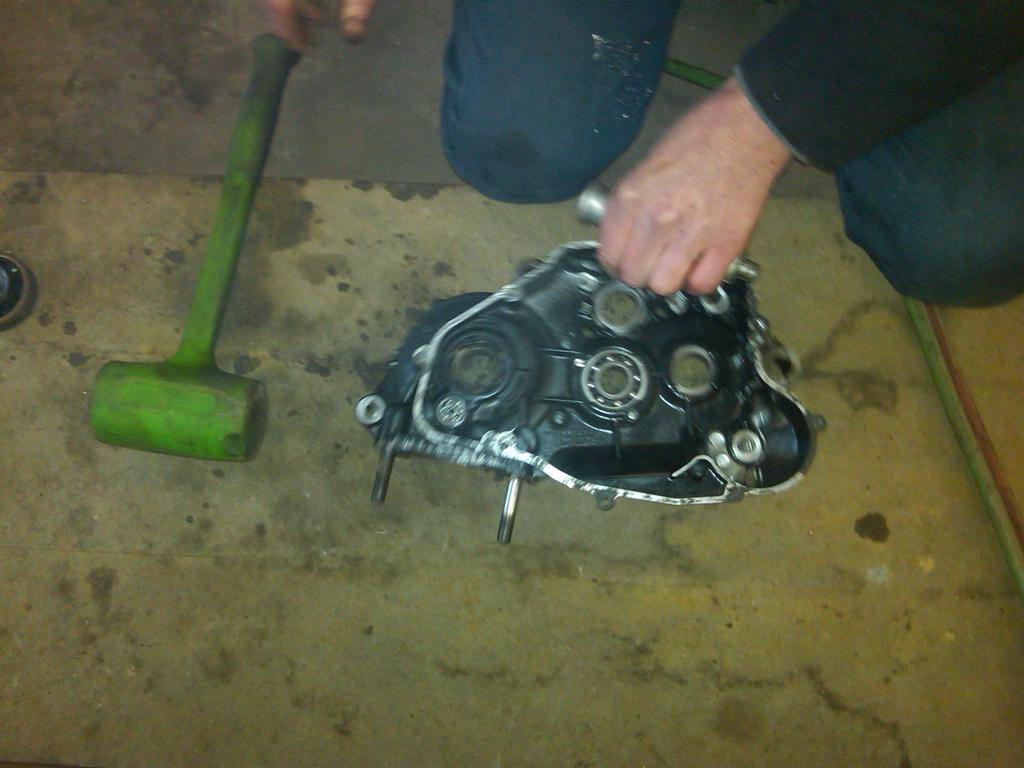

Ordered and received a MOTION PRO case splitter,which at first was confusing, but after sending my wife off to the nail salon(don't ask!) I took some time and got it right.Worked flawlessly and man did they pop, not like a clutch but enough for me to say "oh man" I though it had snapped the case! Now mind you I haven't for 15 years split a case, so everything here is new to me.The cases have no gasket between them, and that's stock, checked in the manual.The cases inside were quite clean, but I expected that due to the ATF that was run in it prior to my purchase.
Now I have a couple questions mabye you guy's can help me out with.The crank bearings themselves, do I need to heat the cases up to remove them from the case?Or can I remove them with a bearing installer and dead blow hammer? Also, it is like 15 here, should they at least be room temp before trying to remove them?The garage isn't heated and they are pretty cold to say the least.I'll need to check the run-out on the crank, and I am going to replace the rod totally as well while it is apart.Do you guys have any pictures of your run out blocks by chance? Also, the lapping of the cases, do you use 400 grit wet.dry paper or lapping compound?600 grit? piece of glass of another method?

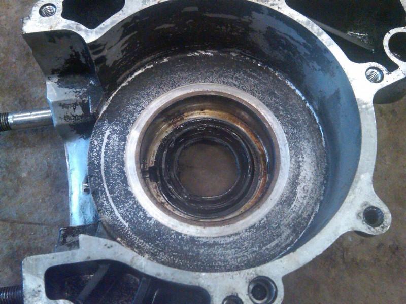

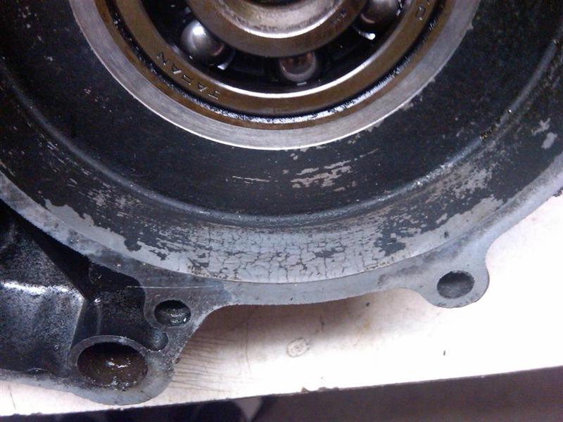

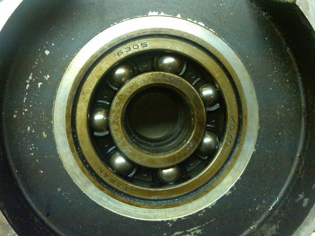

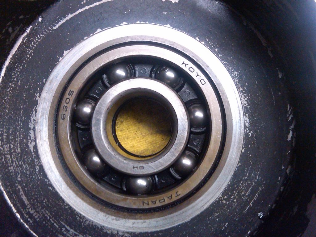

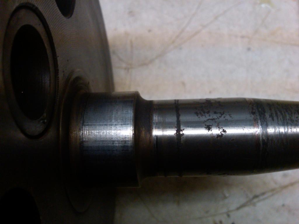

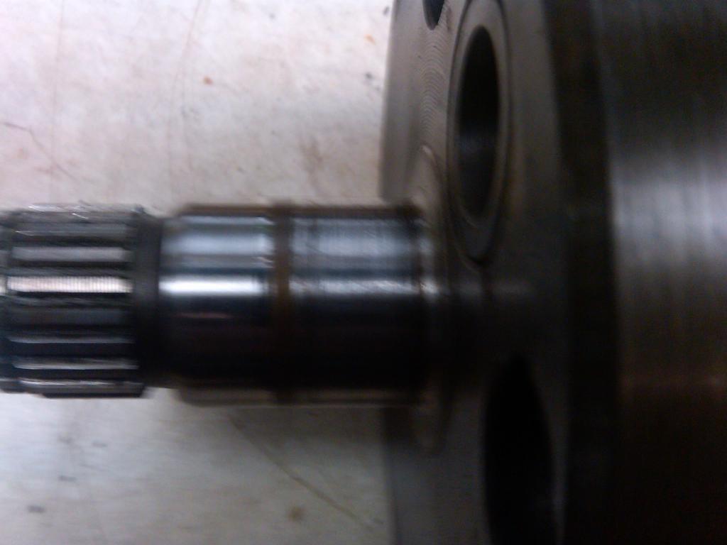

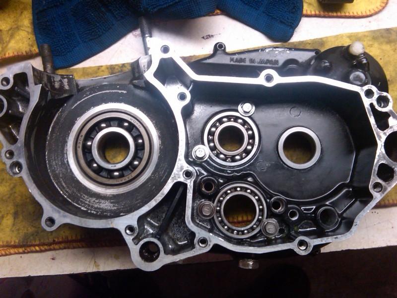

I looked closer at the cases and it appears I was wrong about these pins on the cases, there is none.I will enclose pictures of the cases, there's a area underside of the crank that's appears to be heat cracked-you be the judge.See the discoloration on the crank bearings/they are brownish in color, is that water related or heat? They spin but there's resistance on them for sure.
File comment: crank bearings,see the rust color on them?
File comment: other side crank bearing-still in the case, it stayed in when I split them

File comment: see the what I term cracks ON THE SURFACES?

that's just casting flaws nothing to worry about.the bearings look like slight surface rust to me.
PostPosted: Sat Jan 30, 2010 12:01 pm
Posts: 432
Location: long island NY
in pic 748.64 KB look at the top right ball is that shmegma on it or is it pitted

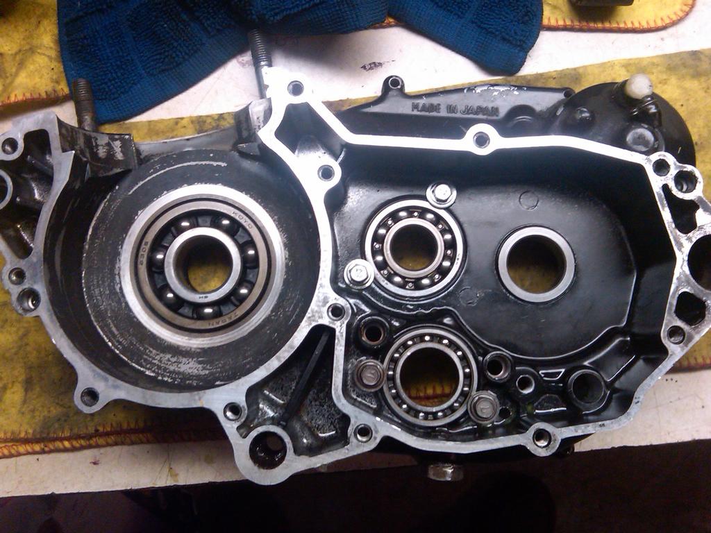

after some chat talk, Hoser has instructed me to install the bearing in the cases first-if you installed on the crank how would you get the bearing into the cases straight?-it could cock-very simple.He is the man for sure.Thanks Hoser.

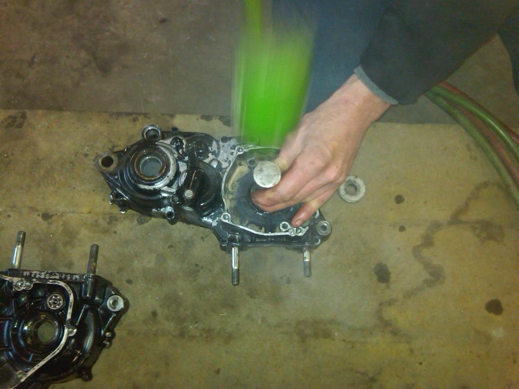

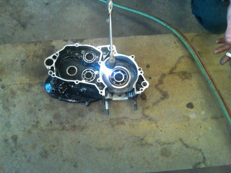

Cleaned the case halves today-and then proceeded to take the seals and bearings out as well.I heated them with a torch lightly, and they popped right out-I included the sprocket shaft as well, as it looked trashed and wasn't freely turning by hand.I am waiting for the new seals/bearings for these cases,and I need to lap them in the week coming as well.
File comment: what can I use for the rust here?

PostPosted: Sat Jan 30, 2010 7:04 pm
Posts: 432
brass wire brushes is what i use to clean aluminum

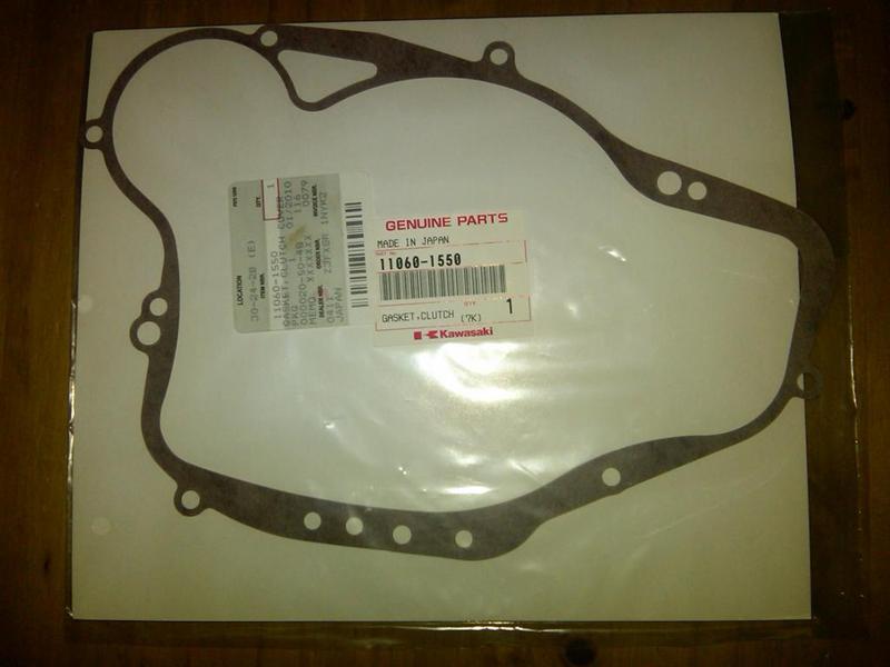

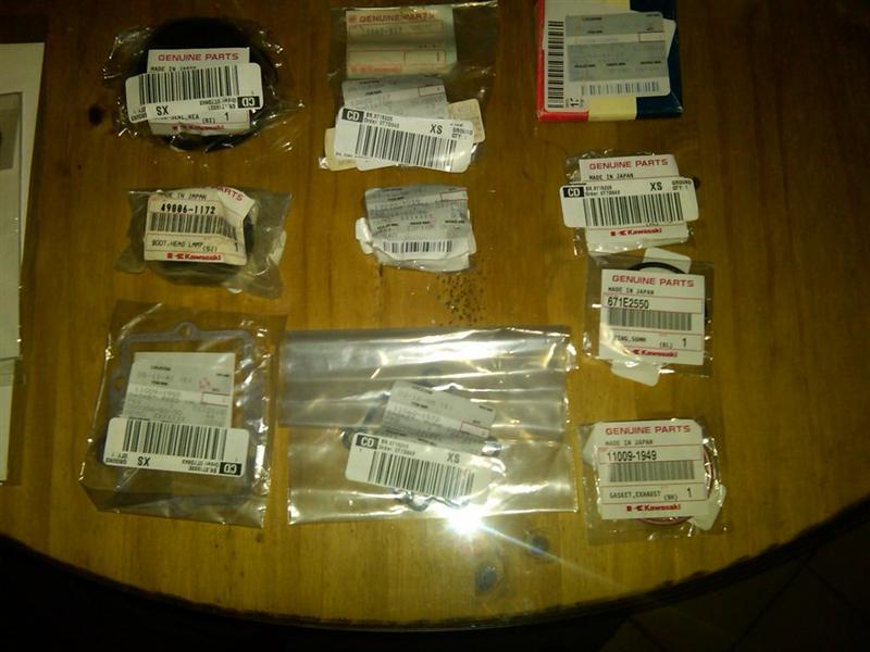

PostPosted: Tue Feb 02, 2010 9:01 pm

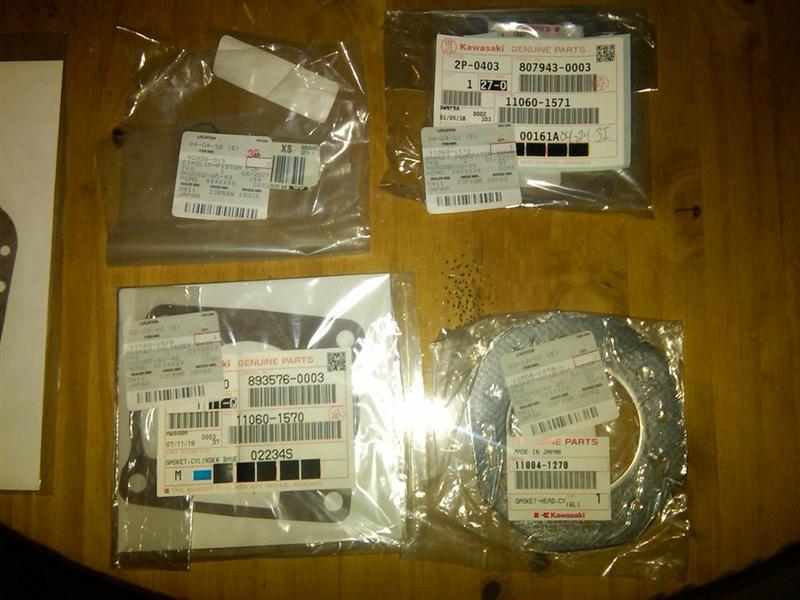

Got some new parts in for the project, not enough to start the Engine rebuild yet-but hopefully soon.
File comment: Jug and piston OEM new!!!

File comment: OEM parts all off them.
File comment: Gaskets OEM nice find!!

Mudbogger just a heads up.the head gasket you have there is some kind of antiseize gasket paper material.i just did 2 topends on 2 little 85 rm80s for my buddies nephews and they were the same kind of gasket material and both had water leaks from the head gasket.i went and got another set and 1 sealed and one didnt.when i took them apart the paper part of the gasket started flaking and falling apart. its that paper material they used it doesnt do well when it gets old.just something to watch for.hope it helps jim

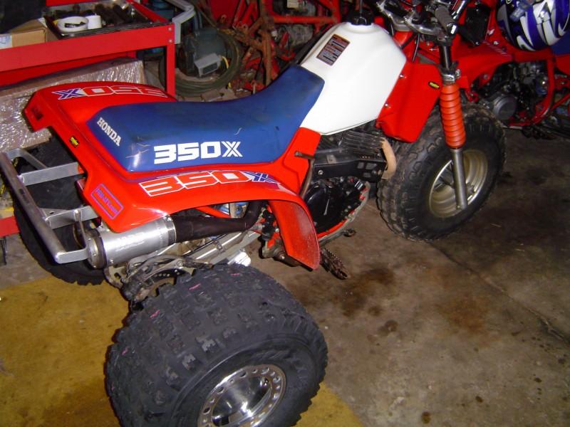

here's a current pic of the ride before it went out for Engine work.
