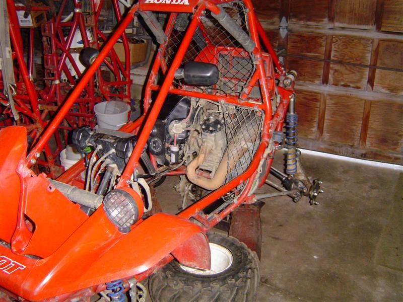

Bought Pilotnuts old Pilot from him so time ago and have just gotten around to CSI it for repairs, I documented some of this in my PROJECT PILOT #3 ODYKID and wanted to start a entire new thread on it.The pilot when I got it wouldn't roll at all, I quickly noticed a rear caliper issue as the pads were worn uneven,missing springs for cable return and idiot light, the e-brake cable was siezed tight-but little did I know it was something else totally-ok,NO PROBLEM, LETS LOOK AND SEE WHAT ELSE IS GOING ON-Frame in front has taken a hit as the front bumper mounts are ripped off and there is a noticeable dent in bottom tube,needed a service badly-air filter was clogged wih mud terribly-needs front end and rear end work, skid plate missing,belt bad,tie rods bent,spindle bent on left side,tie rod ends worn,missing cotter pins, castle nuts,a-arms bent LS,sperical bearings siezed rear and front arms, 2 bent rear suspension arms,CV boots bad-CV's NEED SERVICING on both sides,no battery,these just appart from a quick look so far.
I started with the rear end first as it wouldn't roll.Took the rear caliper off, brake shoes were aftermarket and the e-brake cable was siezed.Removed the caliper and for the hell of it tryed to spin wheel, wouldn't spin, hmmmmm.CSI and found the left side bearings inside carrier totally siezed solid-so that explains it.REMOVED THE BEARING CARRIER and then noticed the upper arm was not falling, CSI'd that and found the sperical bearings wiped out, the arm wasn't moving up and down at all, need to replace the bushings or the complete arm.Also noticed the upper tie rod on the bearing carrier was toast-needs replacement.OK moving on, figured the rear was apart, now is the time to check the axles stubs and cv's, the boots were torn anyway and after reading this off the tech PAGE
http://pilotodyssey.com/800reasons.htm
there was no way I wouldn't do this.Good thing I did, the CV came right apart in my hand, boot tore away and the axle fell right out of the stub, there was no c-clip inside it to hold the ball bearing into the axle stub-good thing I was checking huh?Shocks appear to have leaked oil out of them and I think Pilotnut told me they were in need of a service-I'll replace them both sides with spares I have that Hoser did for me some time back-
http://www.pilotodyssey.com/PO/viewtopic.php?t=3109
SO FAR WE HAVE THE FOLLOWING on left side;
wheel bearings and seals,cv boots,spherical seals, circlip for axle stub,upper arm replacement,2 bent susupension arms lower,rear brake kit,e-brake cable and a upper tie rod for the bearing carrier.Order from SERVICE is coming soon indeed.Heres a picture of the rear before removal of items:
File comment: left side CSI going on-

Moving on to the right rear side now-bearings carrier is fine, no deviaions in seals or bearings,CV boots torn and being held on with zip ties-rear arms have been replaced with HOSERIZED ones so nothing needed-upper arm sperical arms will need to be cleaned and lubed as the travel on them isnt smooth-a clear sign of dirt and debris inside of them-axles will need cleaning and grease/boot replacement.Order from SERVICE following for his side:
cv boots outer and inner kits, spherical seals.
Now-as I said I have both axles out but the stubs are still in trans, I had one hell of a hard time getting them out as I have no welder here to fab a puller-I do it the old fashion way of pulling it-LOL.It turns out the old fashioned way works with a generous dousing of PB Blaster-stuff really works.I wish I had a puller like Hoser does in this thread:
http://www.pilotodyssey.com/PO/viewtopic.php?t=454
So I got the left side out after 3 days of soaking, and then used a brass punch and inserted it through the trans till it hit the other axle stub and popped it out-both clips at end are to be replaced and the splines are rusted -but not peened over and still in good shape-I cleaned the with a wire wheel and then cleaned the thru shaft with a steel brush/toothbrush/brake cleaner and vacuum, then ANTI SIEZED the hell out it for axle insertion later.When I insert them I will doing this mod to them as it is documented that it helps keeps debris from the axle splines:
http://www.pilotodyssey.com/PO/viewtopic.php?t=456
Moved on to the motor (( Internal Combustion Engine ? )) now- did a compression check(152psi)and leak down test(5 pounds for 30 minutes then I let the pressure out) drained balancer and trans fluids, coolant,and took rad out for flow test/boiling at rad shop.Fuel filter is black and clogged-air filter is totally clogged-removed the air box and checked the intake, was clean(surprising but nothing there)as was the carb slide-removed and cleaned air filter a must.Coolant resevior is cracked, missing the rubber grommet that holds it into the air box and has duct tape over hole-needs replacement.Fuel doesn't smell but I'm going to drain it and check fuel cell for rust/sediments.Also the fuel filter rubber is dry rotted and shot, need new one.Heres a list of iems ordered for here:
fuel filter
fuel filter rubber
resevior for coolant
rubber grommet for rese
fuel line to carb
I run Mobil 1 synthetic oils in my rides and will replace both balancer and trans with this, fuel is mixed at 32:1 AMSOIL.Tank was drained and cleaned, re-installed and filled with fresh fuel.Green antifreeze replaced old coolant-alitttle over 2 gallons if my memory serves me for a complete fill of the system(don't quote me here).I of coarse filled after replacing rese anf fuel filter/line.
File comment: left side complete after CSI

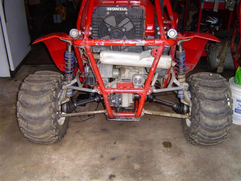

next I went to the front end.I had noticed right off the bat the tie rods were bent both sides, and the front brakes were poor on the handle.I jacked up the front end and immed noticed the front spherical bearings were wiped out on the left side upper arm-it also was bent back and the ball joint boot on the lower was dry rotted and being held in place with a zip tie,no good on all accounts.As I beagn the process of removing the arms I noticed the tie rod end would not come out of the spindle housing, hmmmmm,well the spindle housing was bent badly as well, almost to the point where removal of he joint would have been impossible without cutting or heating up and rebending of he spindle, it will need a total replacement.As the process went along, the brake are in need of replacement and the hubs needed cleaning and a light sanding of the brake surfaces(mud and grime buildup).I happened to have a spare set of a-arms I purchased from Odykid so I used them with the urethane bushing kits Hare had gotten for us:
http://www.pilotodyssey.com/PO/viewtopic.php?t=2798

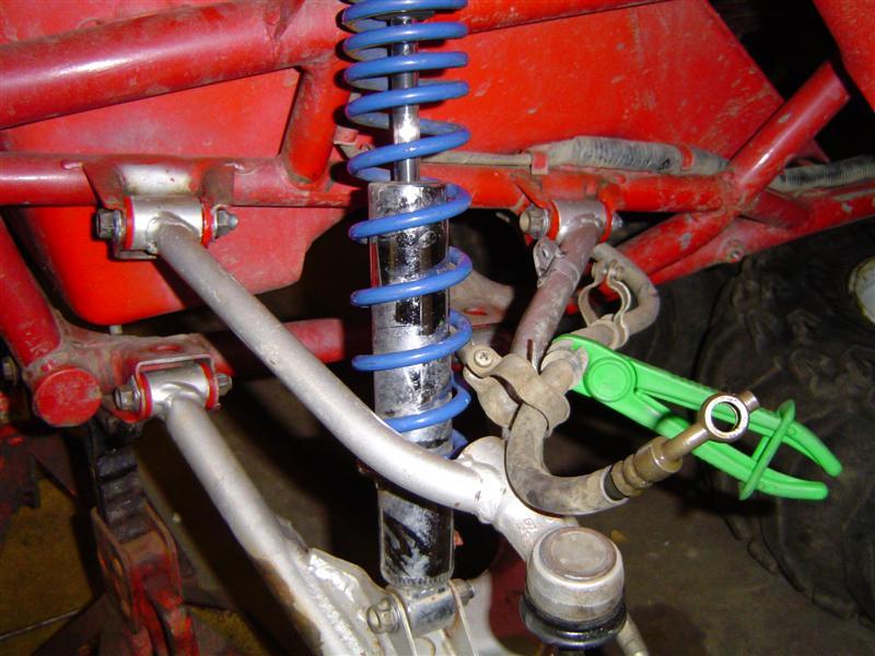

these work great and I highly recommend them.I also bled all the old dirty, cloudy fluid from the master and replaced it-the adjusters were locked up as well so I removed them for servicing.Brakes shoes need replacing.
Next is he right side-same deal here, he spherical joints are shot in boh arms, the lower ball joint was bad,and the wheel bearings on this side are loose and bad-seals will be replaced too.
So, needed from SERVICE is following:
front brake kit left/right sides-think these can be ordered still as a kit-
LS spindle
Wheel bearings/seals
tie rods(4)
I have a set of Hoserized tie rods I will install they are twice he thickness of stock.
I will install the urethane bushing kits on both sides with the new arms from Odykid I purchased.
Service and re-install adjusters
I'll replace both front shocks with newer ones as the rears were bad-the left side shock appears to have a bent shaft as well from the damage received prior to me purchasing.
File comment: spindle out,urethane bushings installed, newer shock installed

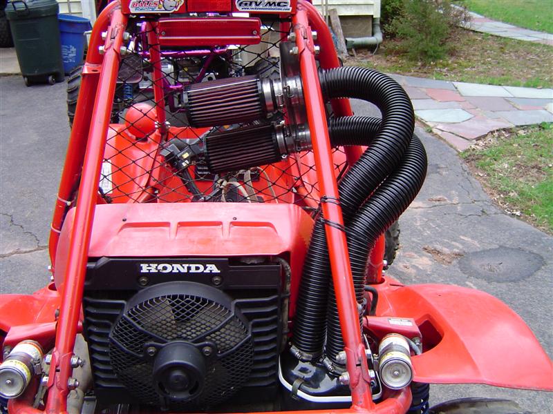

I also installed a dual air intake system on the Pilot-I got the bracket from Cafercr and the filers are from Odykid, they are K&N filters.The tubing is RIGID 2 1/2 shop vac tubing I purchased at HOME DEPOT-slid right on the pipe.I have also fixed many many small things such as headlight brackets-numerous snapped bolts,re-routing wire harness, small things but all needed.
File comment: new used plastic installed, even rooflid.

File comment: dual air intake system front view,will change out OUTERWEARS for old fashion panty hose for a pre-filter on them-CAFERCR fabbed the mount for me -kudos to him for doing it!!!

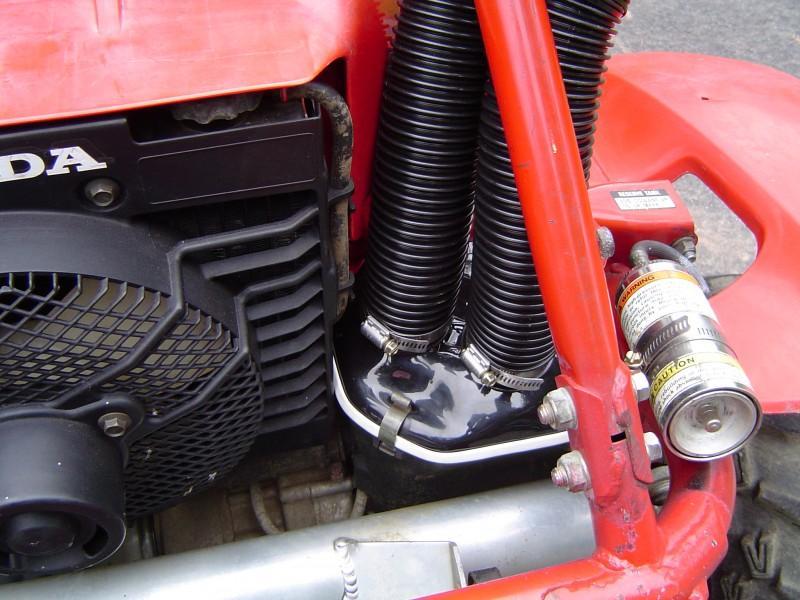

Ok, finished the dual air inlets system finally, I had to rejet the stock carb as I am so busy with work the 39mm mod will have to wait for a spell, and I wanted to see how the stock carb would perform anyway-the internals I had when I started where:
J35A NEEDLE on top clip??????
stock slow jet
140 main
air mixture screw 1 1/4 out
I (as per the chat and tech pages) went up a size on the main and lowered the clip-thus rasing the needle for more fuel.I did the old fashioned method of this by spinning the carb in the boots on the Pilot, I would tell all if you plan on doing this IMO you need a good nights sleep as it can turn your day around for sure-it isnt easy but I really didnt want to start taking the whole air box out-etc etc so I did it that way.I ran the carb out of fuel before I did this (just for the newbies out there)Current jetting is slightly changed:
J35A needle on second clip
142 main
stock slow jet
air mixture screw 1 3/4 out
Plug chops are nice and tan-it was a chilly day here when I performed this so I am going to have to fiddle with the air mixture as the weather turns warmer, but current jetting was spot on, from dead stop to 1/4 throttle it blubbered ever so slightly on dead start, then crisp response to 1/2-1/2 to full throttle it pulled throught with flying colors,crisp throttle response and as I said nice tan color on the plug-smoke ring was alittle wide but as I said I'll adjust with the air mixture screw for that.I am happy with the jetting and performance of the carb so far, but a ride will also be a test/tune as well for a total review of the stock carbs performance.
