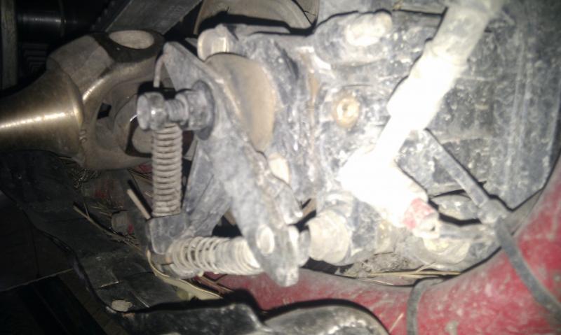

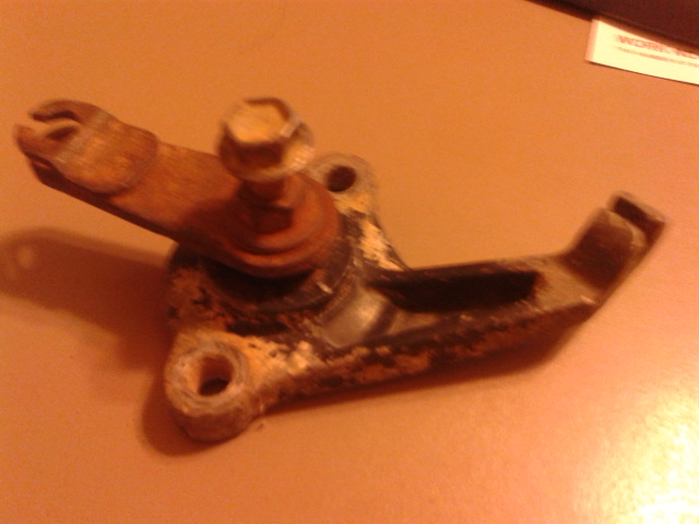

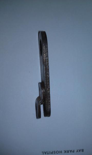

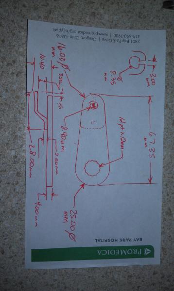

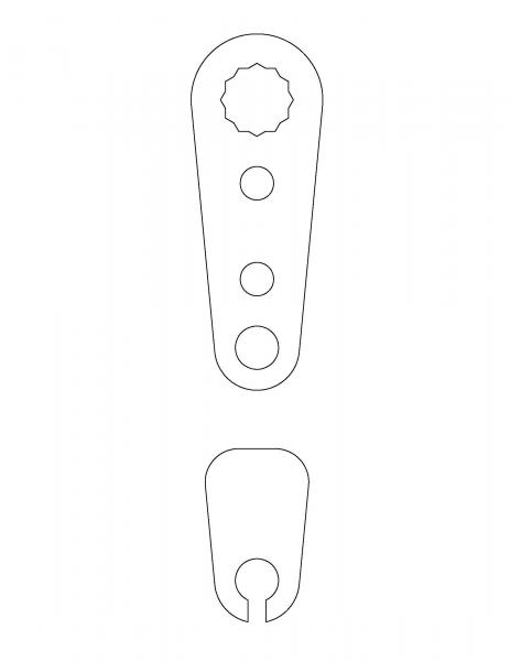

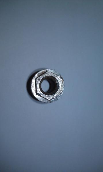

Here's the Oddy lever...
The geometry of the funky part is a 12pt x 12mm, and the little cam piece simply has a 12mm hex bolt head. Threads of the bolt are M8.

My sketch was posted here:
viewtopic.php?f=5&t=11518&start=25
About 2/3rds the way down the page.
D$, you consider having them lazer blanked?
Simple press brake operation to bend the small tab and weld in the barn.

I don't know a laser guy, but that 12-pt pattern is really just 3 small squares rotated 120-deg. A plasma may be able to cut it, but laser would be better.
You could always hack up a 12-pt socket and use it if you were desperate.

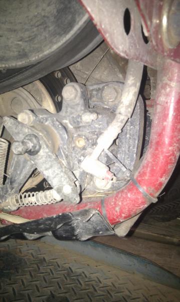

Not a great picture, but Im sure this is from a 350. The bolt is a little bent, but the bracket looks to be good.
Is it worth about the same as Pilot side panels????
