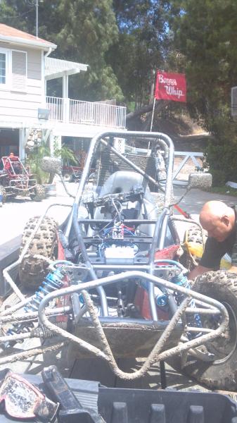

PostPosted: Tue May 28, 2013 12:21 am
Car.
 Post subject: Re: wanted Drakart frame
PostPosted: Tue May 28, 2013 12:34 am
shoubadaba wrote:
Car.
damm hit right in the center?
also whos the bald guy?

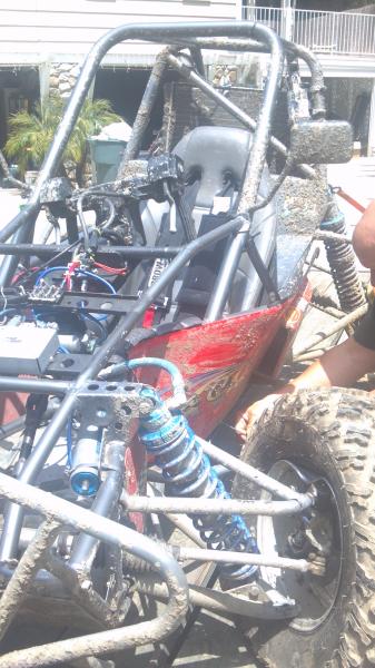

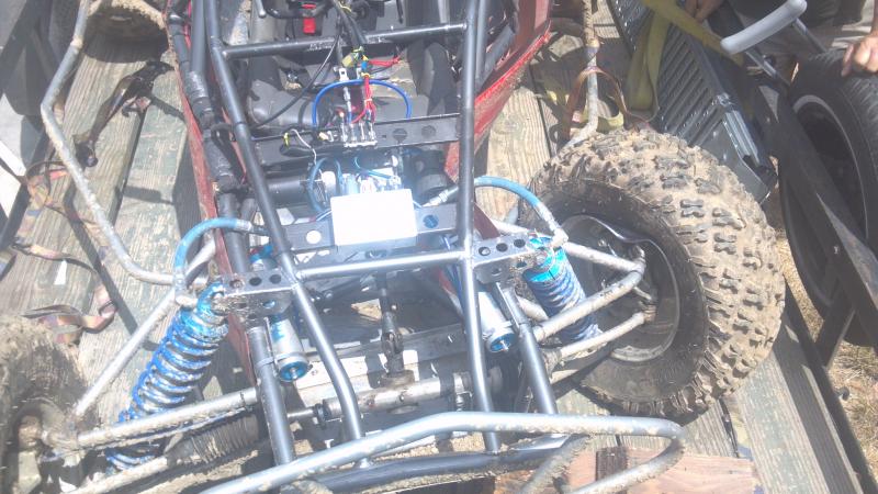

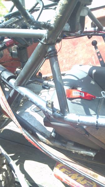

PostPosted: Tue May 28, 2013 1:09 am
Nope he hit with the left front suspension. that's halo in the pic. First time he has seen the car since he got out of the hospitol.
PostPosted: Tue May 28, 2013 1:20 am
damm im surprised he diddnt get hurt worse than his knee
that looks knarley
no fixing that
get better halo
PostPosted: Tue May 28, 2013 2:25 am
The car is getting cut at the b-pillar (bar right behind the seat) and a whole new car will be built from the b-pillar forward. New cage and all.
PostPosted: Tue May 28, 2013 9:22 am
Dayuum!
no diagonals in the front?
PostPosted: Tue May 28, 2013 10:20 am
bullnerd wrote:
Dayuum!
Looks like it has as much or more bracing as a Pilot or Odyssey does.
PostPosted: Tue May 28, 2013 12:11 pm
It has bracing but no enough. The upper section had no cross bracing and the frame is just mild steel yet the arms are chromoly. The arms proved themselfs to be strong and none of them bent or broke. The chassis will be x braced under the leg area and the top tied in as well so this doesnt happen again.

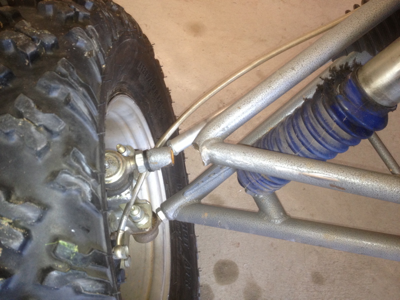

PostPosted: Fri May 31, 2013 3:58 am
Posts: 539
Location: Nebraska
shoubadaba wrote:
<snip>
I don't know about this ?
I endowed my 2003 Drakart Extreme last month 3 times in soft sand and my front left Arm broke clean in half.
I also managed to almost pull the forward mount of the trailing arm off the frame outside the weld.
This was a slower speed tumble down a dune @ LS - I still don't see how your left Arm survived a direct hit ?
I really wonder about its true integrity ?
