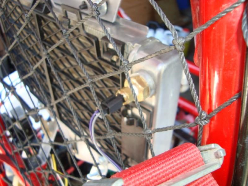

Hey Jim, are you going to plug the holes in your radiator where the thermo switches are? If you didn't have them welded over and are looking for a plug to fit in them the threads are a M18 x 1.5. I used an Oil pan drain plug Dorman # 090-114.

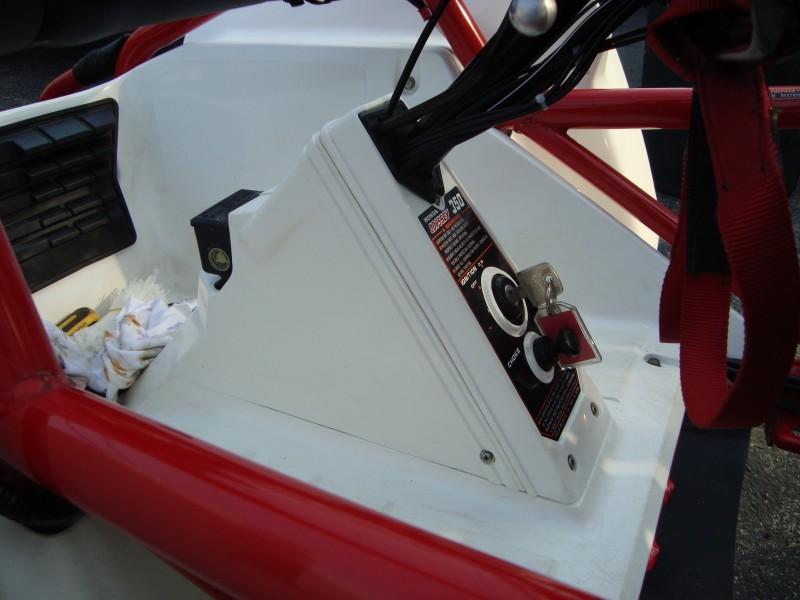

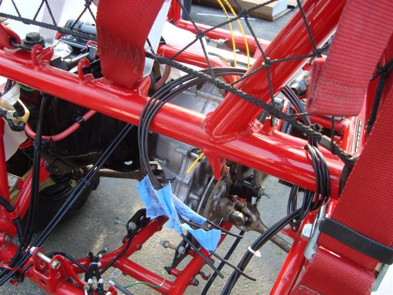

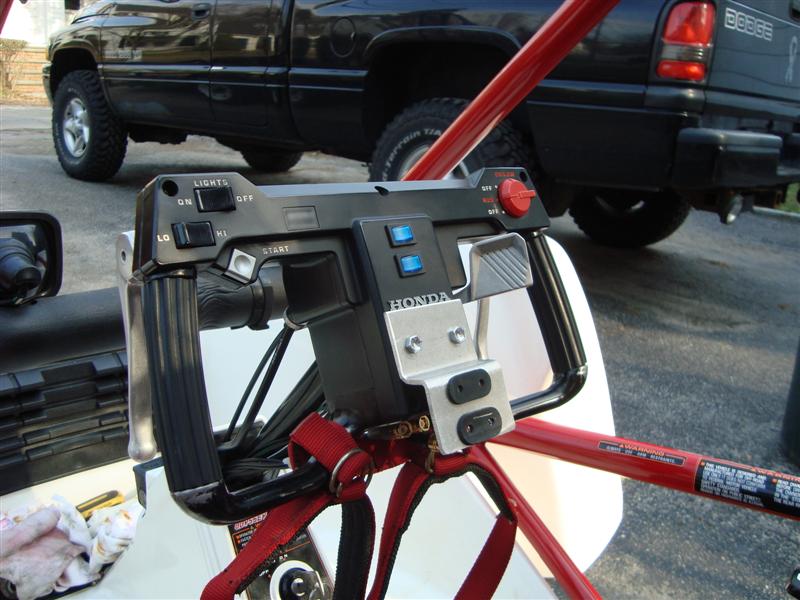

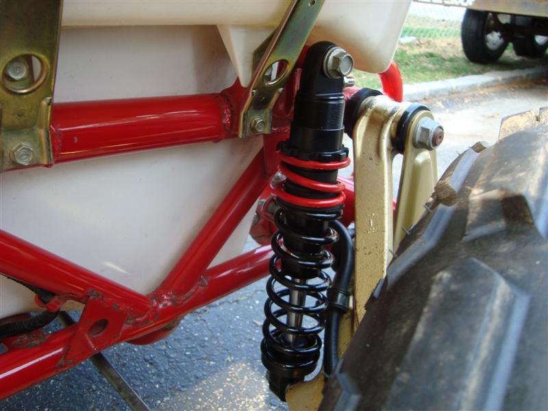

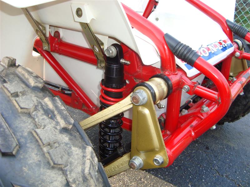

ok spent the day working on the oddy.ran all the wires for the switches,installed front works shocks,flushed and serviced the brake system.

PostPosted: Sun Mar 21, 2010 9:28 pm
What are the two switches on the aluminum panel for?
PostPosted: Sun Mar 21, 2010 10:14 pm
Posts: 432
Location: long island NY
that's the mounting plate for my digitron
PostPosted: Sun Mar 21, 2010 10:23 pm
Now that I downloaded it and zoomed it, I can see what it is. For a minute there I thought you had two more switches.

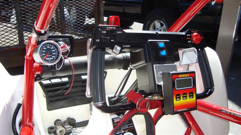

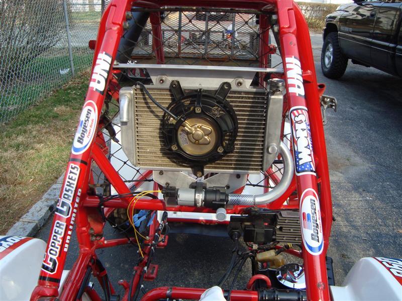

PostPosted: Sun Apr 18, 2010 1:36 pm
Posts: 432

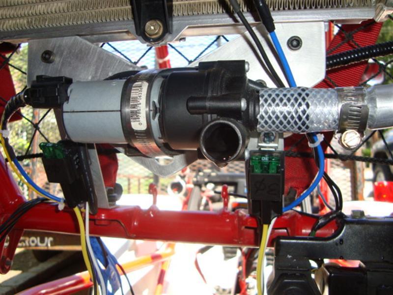

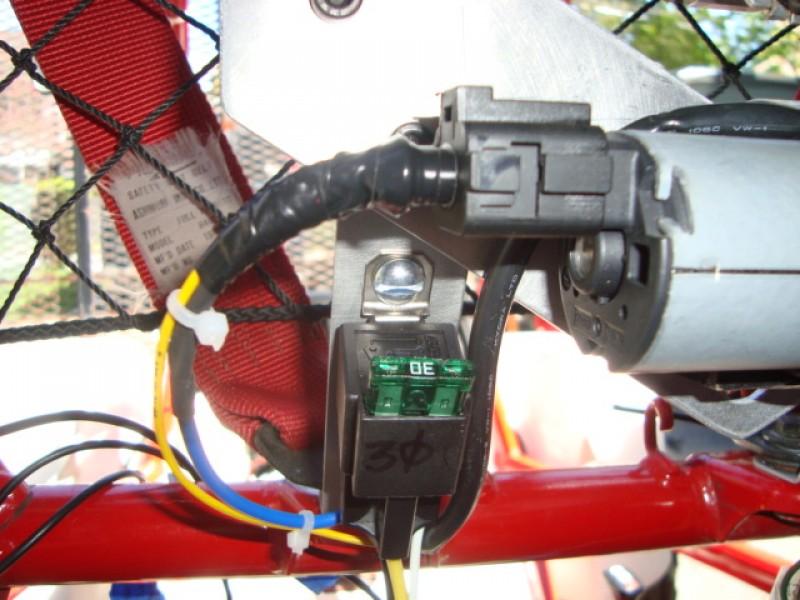

ok played around a little bit today mounted up a new gs series autometer gauge and 2 30 amp relays for the pump and fan.Rand thanks for the info for the sensor plug fitting it worked out great.

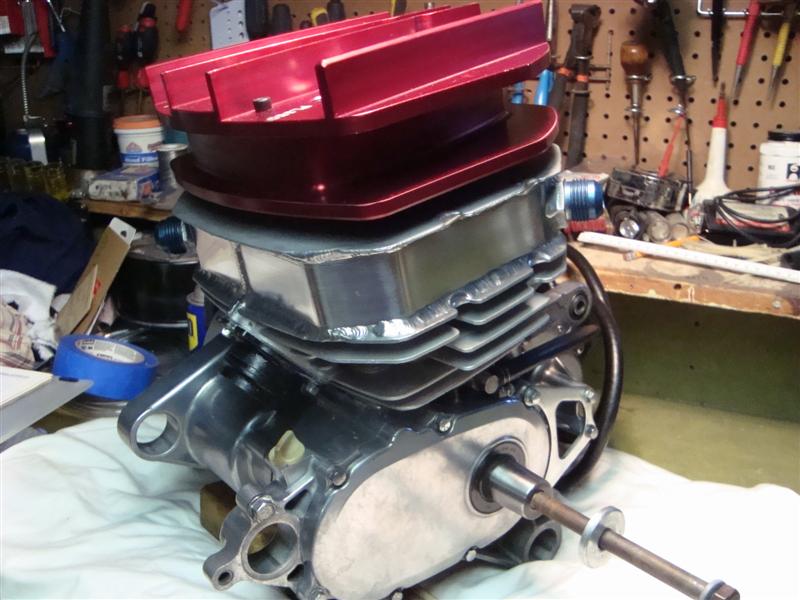

PostPosted: Thu Jun 03, 2010 9:17 pm
Posts: 432

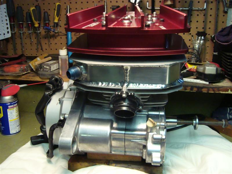

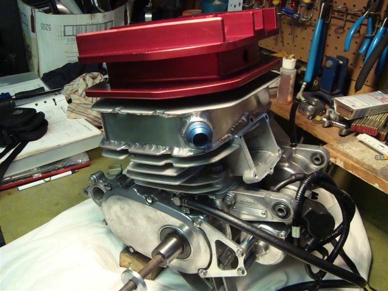

good day today got my cylinder and head from Trevor.the head turned out great two thumbs up trevor.anyway heres my numbers .035 removed from cylinder.my squish is now .041 and compression hit 178 psi.heres a couple pics
