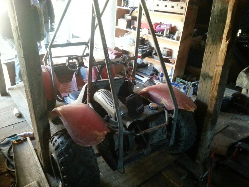

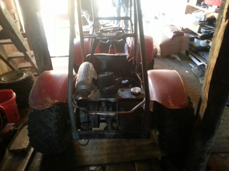

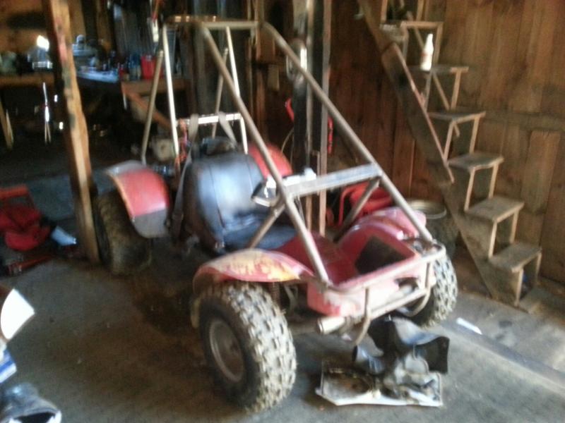

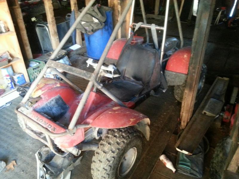

I have an FL250. I guess I was lucky, I picked mine up for $250 with a frozen throttle and brake cable. The cables are free and it runs great, I just snapped the pull-start rope (GRRR) the other day because it's a short rope. I needed to replace it anyways. I like this toy, its a lot of fun to drive and I have decided on keeping it since there are NO OTHER ones at all in my area.
My "friend" who is into 4x4 ATVs makes fun of it, but its a straight chassis (from what I can see) and it runs great. I like the roll-cage too (we've re-enforced it a bit). I am having it professionally repainted this summer and putting the Nerf style padding for bars on the roll-cage. Should look really cool when I am done. I am keeping the red color, it's just too classic to not keep.
do you guys recommend anything? It didn't come with the snorkel kit, safety straps for hands, or the head net. I know the last 2 are probably highly recommended. Any ways I can mod regular netting material into the area to protect the head (IDK if my model had the netting stock).
*BELOW PICS WERE TAKEN THE DAY I WENT TO BUY IT (AT OLD OWNER'S BARN) IT HAS SINCE HAD SOME STUFF DONE TO IT, AND I PLAN TO UPDATE AS WE GO ALONG*

Welcome to the board.....
As far as additional goodies, there is an electric starter kit you can add to your Ody. I believe the manufacturer is Goki.
Looks like the end of the exhaust is missing and or has been modified, you may want to get that or replace it with another after market pipe.

Do you have a pic of what my exhaust is supposed to look like? would that explain extra noise when it's running or is it an aesthetic thing?

What's missing is the spark arestor. It quiets down the exhaust considerably.

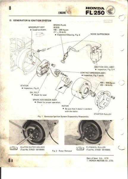

I run a NGK BR8ES spark plug - couple bucks at any autoparts store. The manual calls for a B7ES. The R stands for resistor. BR8ES is "hotter" then BR7ES and BR9ES is "hotter" then BR8ES.
As far as lights - the 77 odyssey puts out 6v AC. I assume you are still running points. Do you have the oem light? If not you could go with the OEM headlight or you could purchase the Goki which will give you a 12 V battery. You can run almost any lights off of that. The goki does not charge the battery. I thought someone on here came up with a way to charge the battery. I ust charge my battery between rides.
You need a manal.
Weres the link for the manual ????
