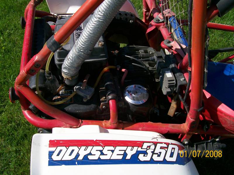

Hello, Came across this forum did some research and bought me a Odyssey :) Also got the Shop Manual!
Went to see it, needs some TLC. Everything works... One pull and it starts, same with electric.
What I know... primary clutch has been upgraded to a Comet 102 series. Top end has been rebuilt with wiseco piston & rings. everything else is stock... Im not sure if the carb is original Ill take a pic.
Im thinking for peace of mind...
Change spark plug, fuel filter, air filter
re-route the fuel lines
new bearings all around F&R
new brakes F&R and master cylinder rebuilt kit, flush new in fluid. Any fluid recommend?
change the oils.... Should I use the Honda4? as per manual or Amsoil? since the Engine been modified.
The shocks are toast! I don't know if I want to drop 1G for new shocks... What would be ideal upgrade New Works rear and find a used front set... or used rear set and new front works? What would be better?
I havent check compression on the motor (( Internal Combustion Engine ? )) yet. I would like to eventually tear down and restore, sandblast and repaint new.
All thoughts are welcomed, I am here to learn and try my best to keep this a classic.

Hello, welcome to the site.....very nice oddy......I am no expert, so I hope others will chime in as well.....
As far as the routine maintenance items, plug, fuel filter, and air filter should be checked and cleaned or changed.
Would be a good idea to get a compression check at this point as well since you are the new owner.
Shocks would be the biggest bang for the buck as far as suspension and handling. I believe there is a front set, hardly used, for sale on this site, please do a search on them..........
The HP4 is a 4 stroke oil and should be used in the balancer and trans if you prefer the Honda brand.
The HP2 is a 2 stroke oil and used for the pre mix for the Engine....again, if you prefer the Honda brand.
Good luck.....and have fun....

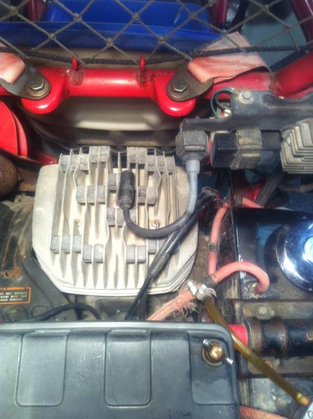

Please take another clear picture of the Engine especially the head, cant really see in the pics but the head looks like a pre-recall head with the straight cooling fins.
Look an the rear of your frame where the serial number is stamped in is their a X at the end?

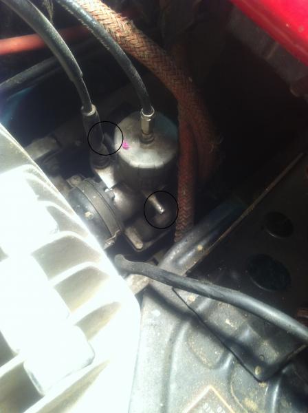

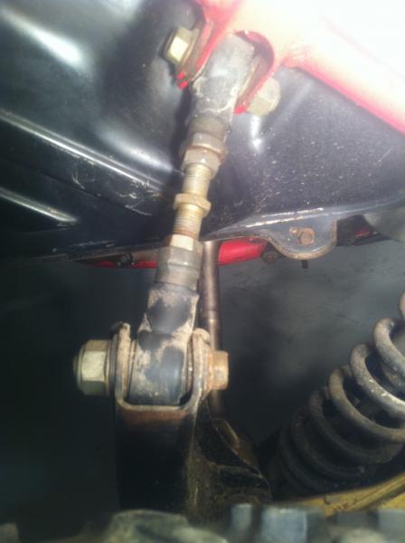

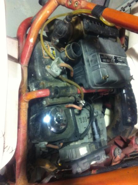

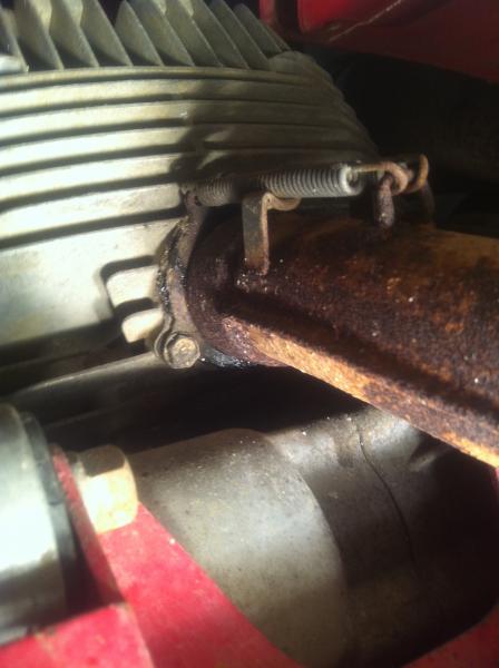

Here is a pic of the Engine... also my RR upper arm looks bent? any confirm?
The Carb is missing some plastic tubes on the side... Kiehin... can I tell if its upgraded?
Let me know your thoughts... thanks
File comment: should I take off the exhaust and clean and put new gasket?
PostPosted: Tue May 01, 2012 11:41 am
Looks like the carb is missing the overflow tubes is all. I believe it is stock.
Also, i notice you have an old straight fin Engine. Those were usually taken out due to a recall for them getting too hot. I don't know much about if they are okay to run or not.
PostPosted: Tue May 01, 2012 12:35 pm
Posts: 221
Location: South Ogden, UT
I've never seen one of those head's on a fl350.
PostPosted: Tue May 01, 2012 12:45 pm
Posts: 1228
Replace that head as soon as you can... They recalled it for poor heat circulation.. a curved head can be had on ebay for cheap!

PostPosted: Tue May 01, 2012 12:53 pm
I beleive if it was recalled about the overheating issue it would have a X at the end of the vin. I'm not a fl350 guy - fl350 experts please jump in.

No X on the end of the vin means that it was an early FL350 and was never taken into a dealer to have the Engine replaced. Not sure if the cylinder is different from the Engine you have to the after recall Engine but i know the head is different. So i am not sure if just replacing the head will take care of the problem.
Here is a nice head on ebay. Notice how the fins have a Y to them where yours are straight front to back? I advise finding out if you should run it or replace the head before running it to hard.
http://www.ebay.com/itm/Honda-Odyssey-F ... ca&vxp=mtr
PostPosted: Tue May 01, 2012 2:35 pm
If it was recalled it would have an X at the end of the vin. that's a before recall head. If you want a curved head Ive got one I'll never use. I'll sell it to you for much cheaper than eBay prices. It's in good condition. PM me if interested.
Oh....and during the recall they reduced the bore from 80mm to 78(I think it was). On the head gasket I'd just reuse the stock gasket. Its a 3 piece metal gasket. You can separate the 3 piece gasket and use a single layer with a thin, even layer of permatex copper spray to bump your compression a bit.

Many other things were done during the recall, they removed the transmission and changed gears or shafts inside to make it stronger, different CDI (Capacitor Discharge Ignition), different jetting in the carb, different cylinder and head, different air scoops, basically they had over heating problems and made changed to solve the problem.
Before recall it was 342 cc after the recall it was 329 cc .
