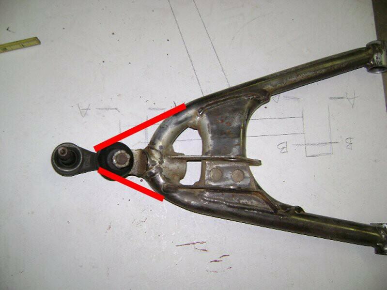

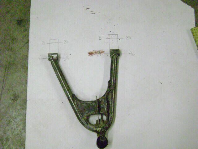

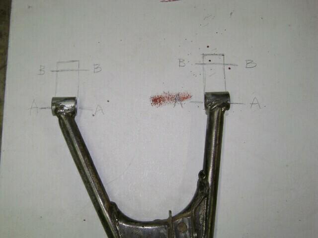

Lee and I had discussed this in the past, take stock Pilot A arms and just extend them 2.5" longer.
Fabricate a jig to hold the arm, where the bolts pass through the frame mounts make 2 more tabs 2.5" away from the stock location, fill the gap.
What do you think Lee?

 Post subject: well
PostPosted: Wed Jun 27, 2007 11:26 pm
Joined: Tue Jun 15, 2004 3:37 pm
Posts: 191
how did they work out?

Hoser, sorry for the delay, we had a storm yesterday and my internet service went out. Apparently when Al Gore invented the internet he did not make it water proof.
I was thinking that an arm that had a bolt on extension could have some advantages.
-ability to restore the vehicle to stock at a later date.
-If we sell kits then the shipping box could be smaller (I would still charge the full amount though).
-We could tune the arm’s flexibility by changing the bushing in the old arm. By having some flexibility we can reduce the jarring to your hands when you hit a rock / stump. We need to make sure the bushing doesn’t allow too much flex of the steering accuracy will decrease.
-We can move the mounting location of the shock. In fact we could do an adapter for using the stock shocks or long travel aftermarket ones.

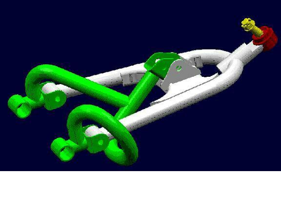

OK, I have an image of what I think we could do to extend the arms:
PostPosted: Thu Jun 28, 2007 10:09 pm
Ok we might as well name it now, looks like some sort of ram horn thing, is that going to drag the ground, how do I bend that up?
I love the concept but we need to refine it a little :-)

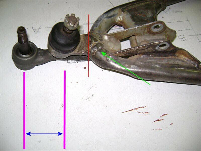

PostPosted: Tue Jul 03, 2007 3:25 pm
I have brought this up before you can still see the "cut here" written on the arm in marker :-)
Cut and fabricate a weld in bung that would be threaded to accept the new ball joint.
Might need to add some gusseting.
