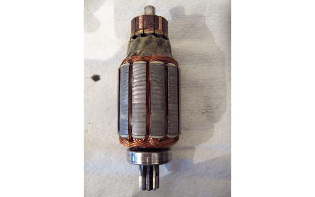

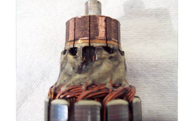

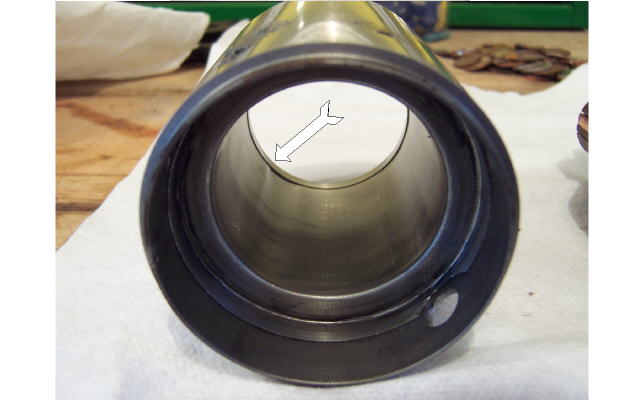

Hey guys pulled my starter apart today and found lots of oil and gunk. I cleaned it up and took some pics. Never had one apart before so im not sure what its suposed to look like. before i order a rebuild kit what do you guys think? thanks

Looks like the armature needs turned.

The armature needs turned for sure, unfortunetely you cant turn one of these very easy. The com is very thin and you cant cut it on a lathe. You should have the armatature put in a lathe and carefully sanded as flat from end to end and as round as possible without going through he copper.
If you install your new brushes on that armature they will wear much quicker then they should.
I am sure their is a local alternator and starter rebuilder in your town that would do it for a few bucks if you don't have access to a lathe.
