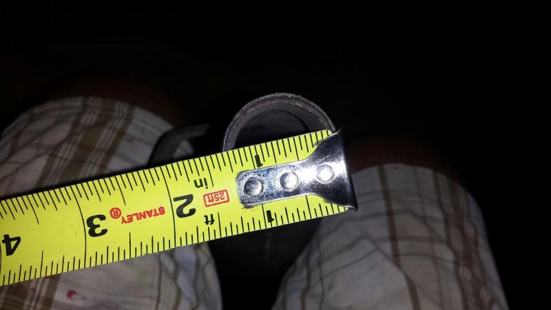

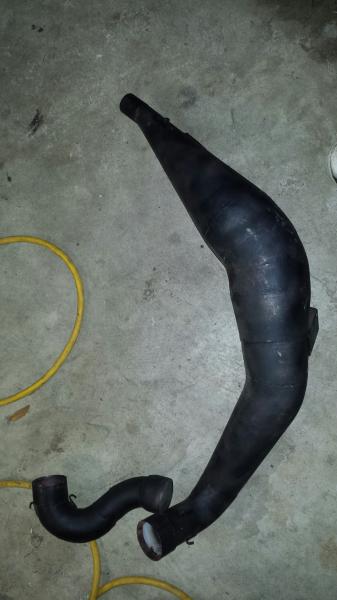

Bought this pipe,completely forgot about the silencer.Its Sposed to be a "rev" pipe
As you can see the O.D. is about 1 1/4"

I emailed the ebay seller selling the fmf a couple days ago,he hasnt answered.Im guessing you have to make a bent pipe to attach to silencer and weld it? I don't have a welder
I also thought about using this silencer
http://www.ebay.com/itm/180642540637?ss ... 1423.l2649
Were all familiar with this one the guy made for the fl350.I emailed him also and havent heard back
The stock silencer wont fit over the end of my pipe,I'm thinking about grinding the inside of pipe on stock silencer to try and make it work

I've modified the stock silencer to fit,needed something by Sat so I made it work
